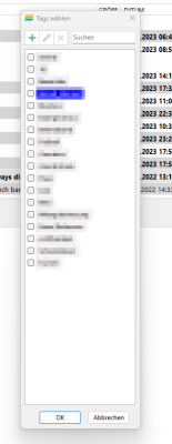

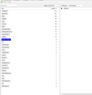

Hello everyone,
When I select an email and right-click on Tags, I do not see all tags as I do when I go to Manage Tags via the ribbon. Sometimes almost half of the tags are missing.

Unfortunately, we are unable to fully see the tags explorer window. The issue may be because there is something entered in the Find field, causing EPIM to only display items that match the search criteria.

No, this was not the case, none of the "Search" fields were actively searched. I have just tested it with the 11.8 beta, here the "error" is the same.
