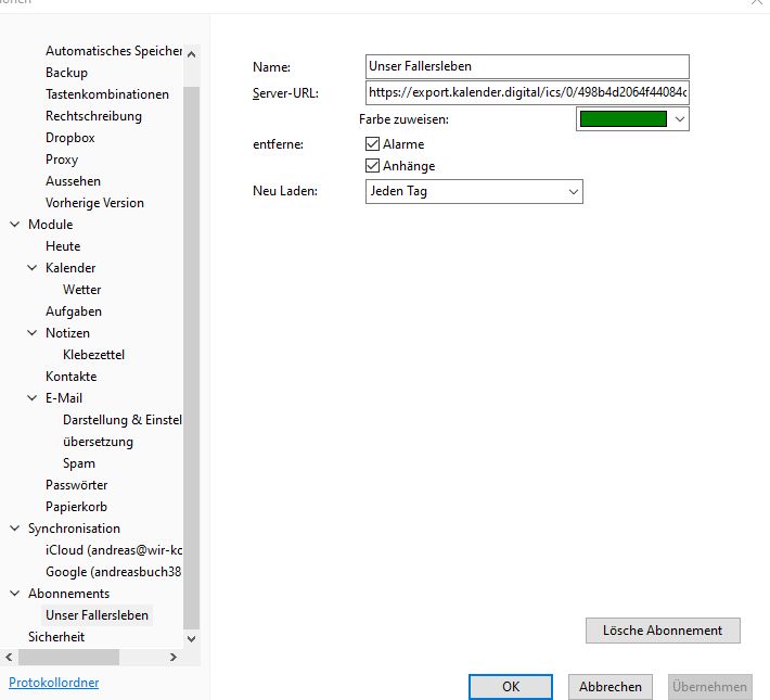

Everytime I cancel a calendar subscription I get an local calendar entry, that I can't delete.
What can I do?
And sometimes there is an error message while syncing subscriped calendar.
What can I do?

Re: Can't delete calendar subscription
11.5.3 pro
Options-Subscription-Delete subscription
Optionen -> Abonnements -> Lösche Abonnement
Attached:
1. canceling subsription
2. empty subscriptions after canceling and renewing. First with the same name. Second with a different name
Hope you can fix!
Attached:
Hope you can fix!

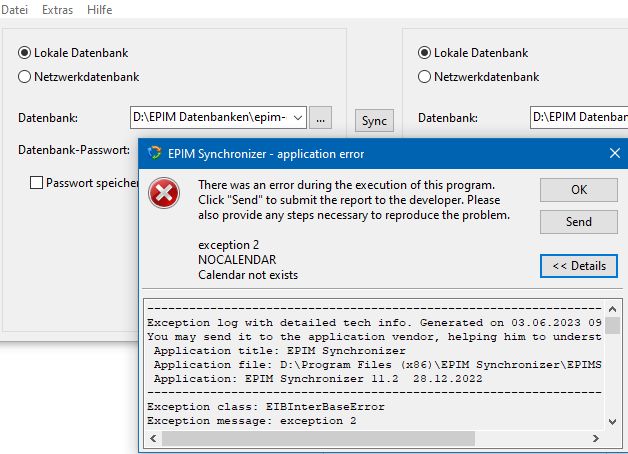

In a new database everything works fine.
Subscribing - canceling - subscribing
In my database there is always an error (see attachment). It appears since several days. That's why I canceled subscription and renew it. And then I saw the duplicate entry. Because I can't rename them, I could not say which one causes the error...
Maybe the "lost" entry has to be deleted with the database itself, but I can't do that. right?
There is no week without some issues with EPim. I am getting frustrated and sometimes a little bit angry. Since I am working with EPim (about 8 Weeks or so) there is always something wrong, disfunctional etc. I like to work WITH the software not AT the software!
- 1.jpg (9.28 KiB) Viewed 1455 times
The problem you're experiencing may be related to the structure of your database or the data stored within it. One potential solution is to renew the database structure by synchronizing it with the new database using EPIM Synchronizer. By doing so, you can determine if the issue persists or if it resolves the problem. If the problem persists, we can explore additional steps to address the issue.
I have done that step yesterday. It fails with a message "that one calendar" doesn't exist...
Used Syncronizer.
database -> databaseNEW
using >> to move content
Then error
Exception log with detailed tech info. Generated on 03.06.2023 09:37:40.
Application title: EPIM Synchronizer
Application file: D:\Program Files (x86)\EPIM Synchronizer\EPIMSync.exe
Application: EPIM Synchronizer 11.2 28.12.2022
Exception class: EIBInterBaseError
Exception message: exception 2
NOCALENDAR
Calendar not exists
At trigger 'TASKS_BI0' line: 5, col: 80.
There's something wrong with the database file as EPIM Synchronizer thinks there are no calendars in it. To diagnose the issue with the database file, we would require the following steps to be performed:
1. Create a copy of your database file.
2. Open the copied database file with EPIM and remove all important data, keeping only unimportant data and all the calendars. You can delete all events from the calendars, if necessary.
3. Optimize the database by going to the database management options, exit EPIM, and archive the modified database file.
4. Please send us the archived file for further analysis.
Thank you for your cooperation.
